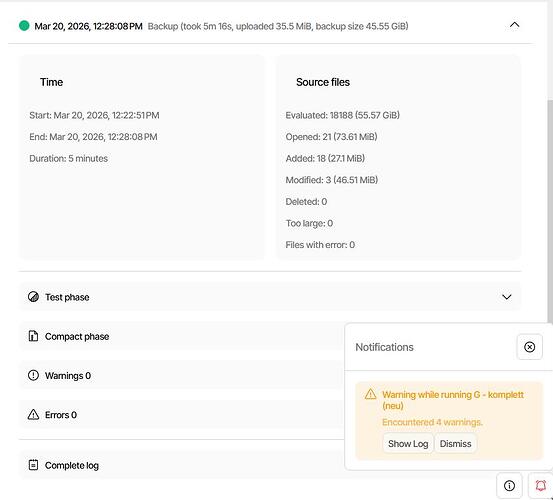

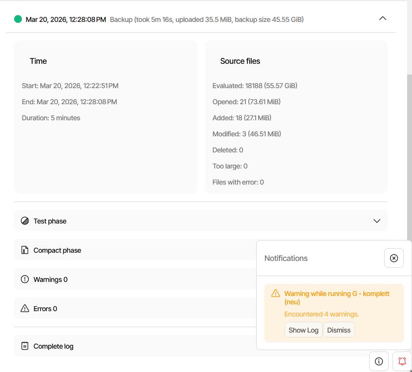

4 warnings in alert, but none in log
(2.2.0.3 - 2.2.0.3_stable_2026-01-06 on Win10) What is the purpose of the yellow alert box, indicating 4 warnings, when there are none reported in the actual log? Or do I need to look elsewhere? Then the “Show log” should link to the correct location.
I found the reason for the alert: It was due to a SendHttpMessage-HttpResponseError with 3 retries. It only shows up in the detailed log (log_level = retry) which has to be specified with an advanced option.
The location is not obvious, since the “Show log” suggests that details can be gleaned from the high-level log on the reporting page.
I suggest improving the dialog to make the location of the detailed information more clear.
