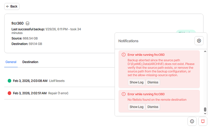

Server crashed and I am unable to retrieve my backups. I have successfully l it on Installed Duplicati on my new server and it shows me connected to to my original account. My new server has a different name than the original. I want to download my files to the new server, but it says “No filelists found on the remote destination. I have chatted with Backblaze and they say it is a Duplicati issue.

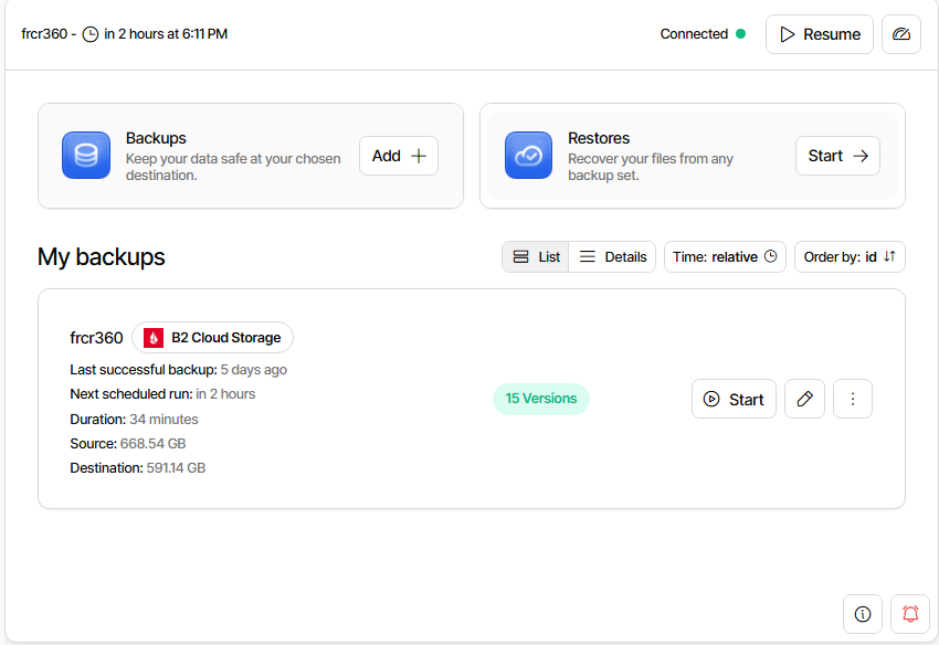

At one point, your (maybe stale) job statistics showed you had 15 of them.

I have actually retrieved the original DB from before the crash and have gotten connected to the remote B2 destination, but I am unable to restore files from the local configuration, direct restore, or exported job. The error in each of these cases is due to the lack of any “dlist” files in the destination. I don’t know why, but there are none present in BackBlaze, despite multiple backups that I believed were completing successfully.
I have thousands of “dblock“ and “dindex“ files though, as shown in Job>Logs>Destination, so there is data present, albeit mostly useless without the “dlist” files.
