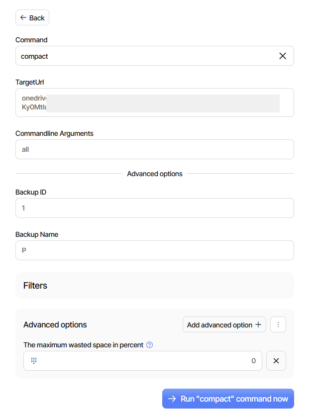

I’ve executed the compact from the new UI on a small backup which has the Extra-entries in 3 dblock files, but it did do nothing:
Then I ran the compact-command from the command-line with the option --threshold=0 which downloaded, deleted and uploaded waaaay more then just the 3 dblock files with the Extra:-Entries.
Once it was done another test-run with full-verification had no “errors” anymore. So it seems to fix it.
Did you change threshold in the Options first? If not, it was a normal compact check, and that runs after every backup unless no-auto-compact option is set.
Compacting files at the backend
The compacting procedure is triggered after each backup, but can be disabled with an advanced option. If you want to perform a compacting operation manually, click on the backup name and click Compact now under Advanced.
As mentioned, the new UI calls it “Compress”, but I hope it respects set options.
It knows nothing about Extra count. It’s removing wasted space to the extreme (because it was asked to). It also filters away the duplicates while repackaging.
You might have been able to lower threshold gradually, but then you’d need repeated testing (or maybe you do test anyway) to see if Extra went to none.
Regardless, you went for it in one shot and it worked, so hopefully it stays good.
I was not able to change it. If you click:
It just starts. So I had to use the threshold advanced option via the command-line:
did I miss here something?
You change it in Options on the job first, like for pretty much anything except “Direct restore from backup files” (which has no job) and “Commandline” which starts from job options but almost always needs tweaking (for command to run, if nothing else).
was a bit too short I guess, but it meant job options:
:light_bulb: I see!
So the advanced-options I set on the job itself are not just for the backup but also for the other commands? I did not know that :slight_smile:
Yes. no-auto-compact is there. restore-legacy is there, and some options naturally apply to most commands. Examples: dbpath, passphrase, etc. are picked out of the full option set (rather than ask) when you do Compress now.
When you use Commandline GUI it defaults to backup and has most options, whether or not backup takes them all. Most commands ignore irrelevant ones.
