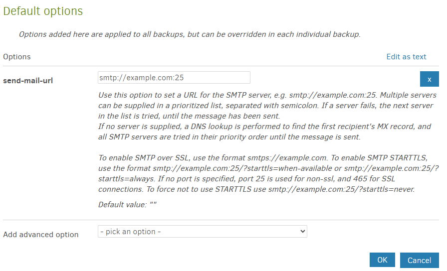

2025-02-07 13:31:52 -06 - [Warning-Duplicati.Library.Main.Controller-UnsupportedOption]: The supplied option ---send-mail-url is not supported and will be ignored
Welcome to the forum @jeffreyswiggins
CLI options start with two dashes, not three.
But I am not setting that to be Two Dashes or Three Dashes… Their Code is. I have it added as a Setting in the Docker Container under DEFAULT OPTIONS so I chose that option only with a bunch of others to use and have assigned before and after every job. It is their code that is now adding that 3 dash I guess because I did not script that.
I write code and use docker compose and other things so I am familiar enough with what you are talking about, but in this case their app provides it so I just used the options in it.
What Duplicati release is that? If unsure, see About in GUI.

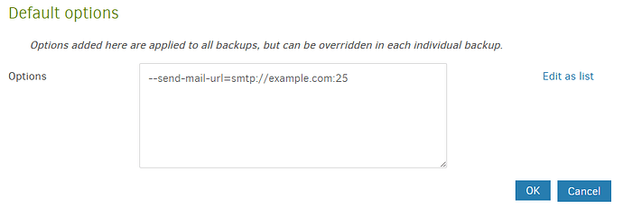

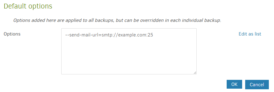

If that means Duplicati Settings screen, what does Edit as text show it did?
It made two dashes for me, as it should. If you added it some other way, what?
I am running Duplicati - 2.1.0.4_stable_2025-01-31
When I checked the Edit as a Text Option it appears there were — Dashes. No idea when or where that 3 dash got added because these settings stay static and do not get changed by me and I am the only one in my homelab. That did fix it for me and the jobs now run without errors and I received my emails!
