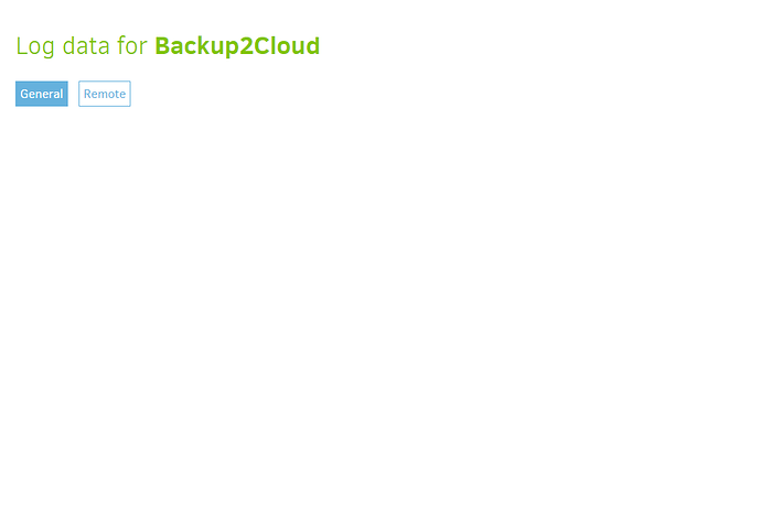

Weird thing is: it also shows the job as if it never has run in the main overview.
The General log is just empty, nothing to see there. In the remote logs there are some entries, but they in themselves show nothing.

The Backendtest was the second run… before the files got deleted, i snapped this picture of the cloudstorage, so something is going wrong here…
So… i´ve now deleted all files and folders in the cloud storage that were created by the past runnings of the job and created a complete fresh job with ssh connection instead of Webdav. It is still running, but the Duplicati.CommandLine.BackendTool.exe list is giving me a list of files now…
So i guess it should work now.
