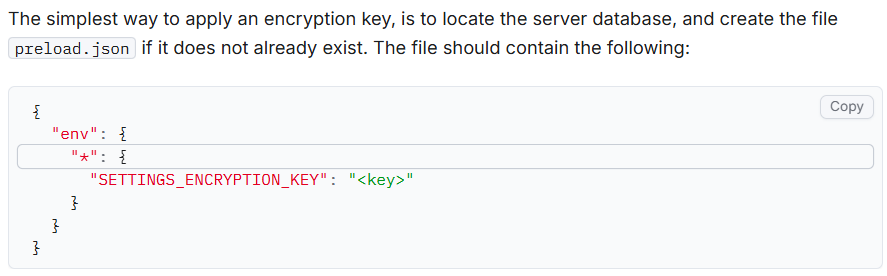

Hi. I’m trying to figure out how to use to use preload settings file to encrypt my database. According to this link, it says I can create a preload.json file. I found the Windows folder were my database file. Then do I
  1. Right click and create a file named “preload.json” in this folder
  2. Open preload.json in Notepad
  3. copy and paste this:{
    “env”: {
    “SETTINGS_ENCRYPTION_KEY”: “<key>”
  4. Save preload.json
  5. Open Duplicati
Also, do I keep these characters “< >” in the json file and only replace key with my actual key?

Everything between the quotation marks is the actual encryption key. The < and > are only included to show the value. Example with the key “batteryhorsestaple”:
{ "env": { "*": { "SETTINGS_ENCRYPTION_KEY": "batteryhorsestaple" } } }
