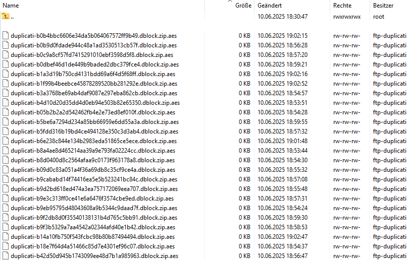

I’m observing a strange behaviour with my proftpd ftp server. Duplicati writes a lot of “0 byte files” while slowly uploading the freshly generated backup files. In parallel, it also writes the 50 MB archives and the rest of files it wants to. The connection is ftp-ssl. During the phase “verifying backend files”, I’m looking “live” at the state on the ftp server changing and see it deletes the “0 byte” files one by one, each taking 5-10 seconds to get deleted by Duplicati. I remember that before the “ftp ssl” bugs came up early this year before the final stable release that the slow downs started. My machine is Win11 x64 24H2 with latest CU applied.
Screenshot:
My backup job still succeeds fine but takes unusually long.
Could you please shed some light what’s happening? I guess adding and removing a hundred 0 byte files is not normal expected behaviour? Can I improve something with my setup or ftp settings?
Other apps can transfer via ftp-ssl about 70 mbyte/sec.
Thank you.
Your system can shed some light with About → Show log → Live → Retry or using options log-file=<path> and log-file-log-level=retry. You can also look in Complete log section of a job log to see if RetryAttempts is kind of high. Failed uploads get retries, and original files that failed get deleted later. Maybe that’s what’s going on, but next question is why upload failed. Regardless, let’s first see what the pattern is behind empty file uploads. Getting a screenshot like you did can work with the log, e.g. you can find file name in a log.
