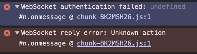

Please find below the errors discovered on the console:
With more info :

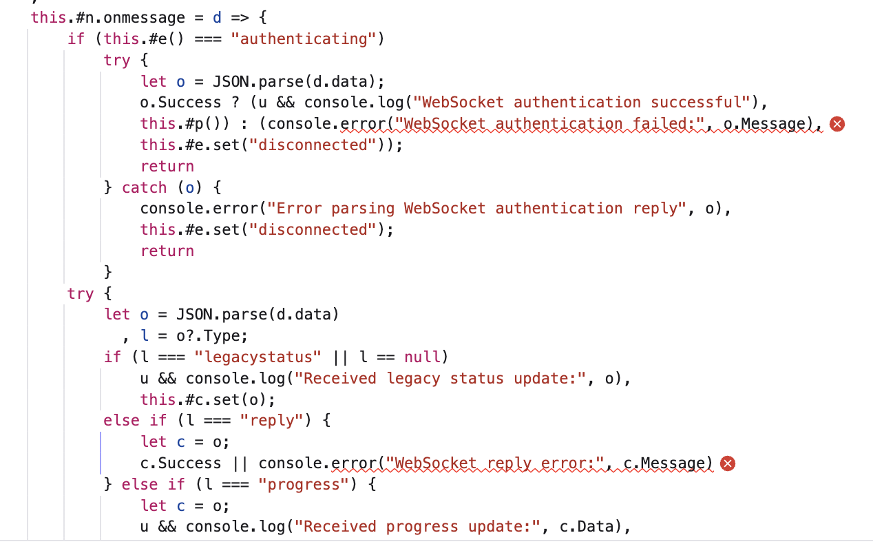

I think the first message: “WebSocket authentication failed: undefined” means that the websocket connection fails somehow. The “undefined” indicates that no data was returned somehow.

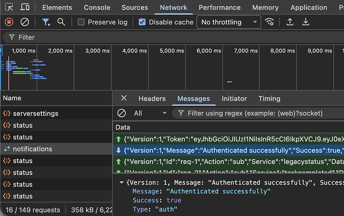

Could you check in the developer tools under “messages” to see what is there?
For reference, this is what it looks like in Chrome:
You can try to disable the websocket by starting Duplicati with:
--webservice-disable-api-extensions=v1:websocket
This will instruct ngclient to fall back to the polling method, and if that works, the socket forwarding is certainly the issue.
Hi ! After running a few tests to double-check that the headers were being transmitted correctly, then trying to disable websocket, I can confirm that it is indeed the WebSocket part that is causing the problem. Error in messages without the module disable is “PROXY_AUTHED_FAKE_TOKEN”. For now, I have disabled the websocket. How can I reactivate it if necessary? (Switching from DISABLE to ENABLE or ENABLED) does not seem to work.
