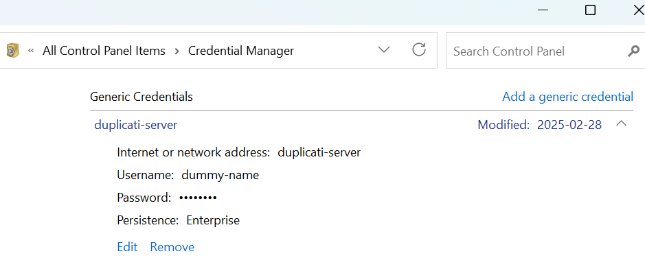

For enabling encryption, it works similarly (as described here), but this time the arguments in the “Target”-property will tell Duplicati where to find the encryption key: “C:\Program Files\Duplicati 2\Duplicati.GUI.TrayIcon.exe” --secret-provider=wincred:// --settings-encryption-key=$duplicati-server. The --secret-provider argument defines in which interface (called “secret provider”) the encryption password is available (in this case, Windows Credentials Manager) and --settings-encryption-key defines which entry in the secret provider provides the password. Of course you need to enter the credentials in the chosen secret provider accordingly before using the shortcut. This is an example of the described setup in Windows Credentials Manager:
